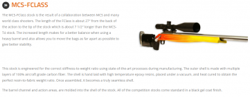

MSC-F-Class
The barrel channel and action areas, are molded into the shell of the stock. All of the competition stocks come standard in a black gel coat finish.
This is not the general machined in action and barrel contour inlet since your action choice and barrel contour are molded in.

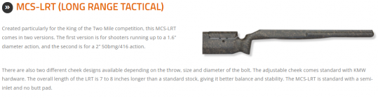

MSC-LRT
Created particularly for the King of the Two Mile competition, this MCS-LRT comes in two versions. The first version is for shooters running up to a 1.6” diameter action, and the second is for a 2” 50bmg/416 action.
Note that this stock is oversize to accommodate the larger diameter actions and barrels. The fish belly bottom on the forearm adds substantial rigidity to the assembly.

MSC-F-Class
MSC-LRT
Can the LRT by used for F class competition ?
