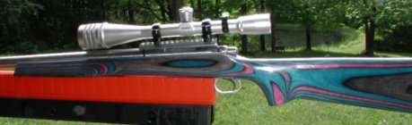

Mine is chambered in 300SAUM. It is a very smooth receiver. Mine is a repeater and I tried to use the Wyatt box and it wasn't very good with my cartridge. I have a modified factory box and follower.
Butch
Butch: How does the modified factory magazine work with your cartridge? What is your OAL? With the slightly looser bolt can you see any discernible drop off in accuracy? Are you using it for hunting?
