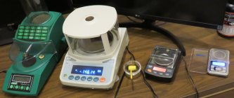

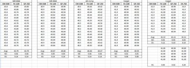

Hmmm??? Based on my "little" comparison (see pic below), and since ES is so important with only one poor measurement making a difference, the FX makes a substantial difference in terms of ES rather than an average FPS.
On the chargemaster tests, did the chargemaster read at 40.9 for all of the charges?
For example, shot 1 was 40.78. Did the chargemaster still read at 40.9?
Yes, that's right. I would trickle up until the Chargemaster read 40.9 then weigh the charge on the FX, which for shot 1 was 40.78.
I use the same method when I did my little comparison of the scales I had to get an idea as to what the different results might be. Maybe you already saw this on another thread?
I have been using a chargemaster for about 5 years now and just purchased the FX. Knowing now that Chargemaster can be off by .1 makes me hopeful I can get some better SDs with the FX
