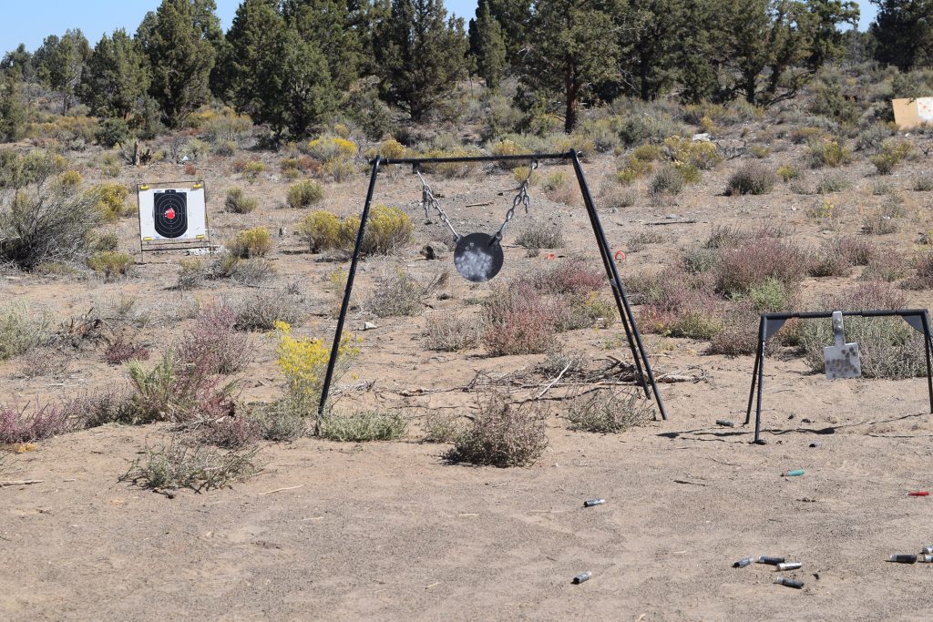

I have several Hangfast targets and really like them. Targets hang on angle so bullets are deflected down. Easy setup and ring pretty good. I could set them up to 450 yds on our property
