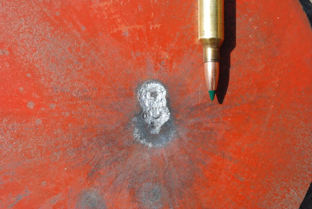

I was disappointed with the AR-500 steel at 100 yards. My girlfriend shot it with her 7-08 and made a little hole maybe 1/8" across and 1/16" deep. Then I shot it with my 204 ruger and I was surprised what that little fast round did to the steel. Her shot is right at the bottom and I did a 3 shot group above with the 204. This was 100 yards.

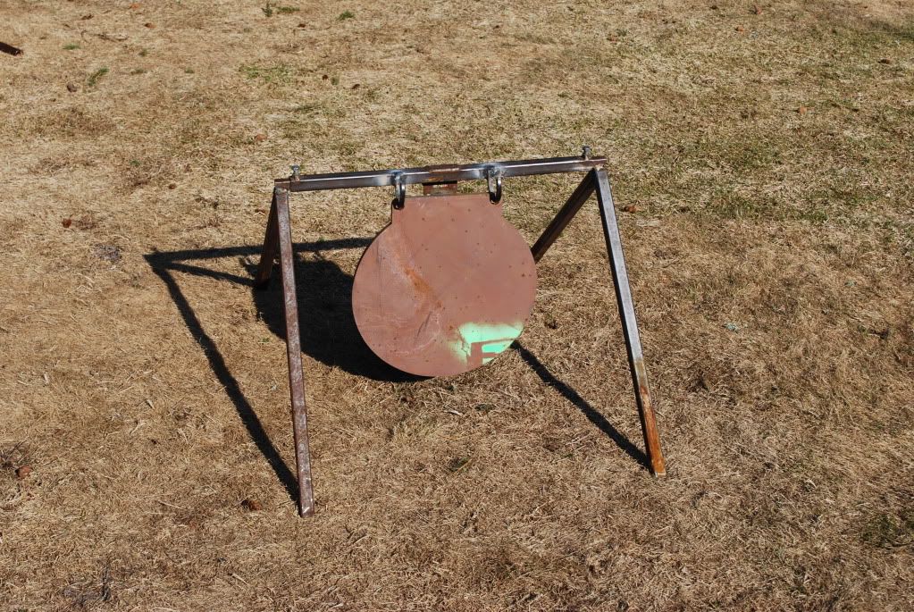

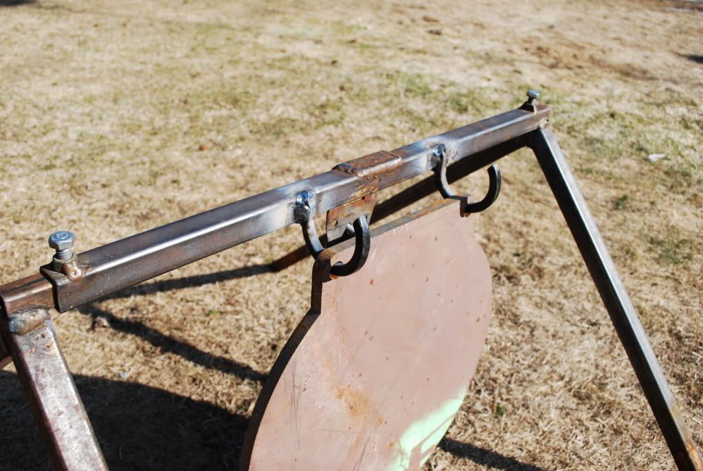

I hang my gong at 90 degrees. If I hung it leaning back a bit the damage would be less. Here is my set up.
Now to mild steal. If your shooting soft steel with high power rounds it will make big craters and that is unsafe. I don't like to shoot mild steal with anything that will crater the steel. I shoot it with my 22LR with no problems at all. Just make your targets 1/4" or thicker for 22LR and you won't damage it no matter the distance.
