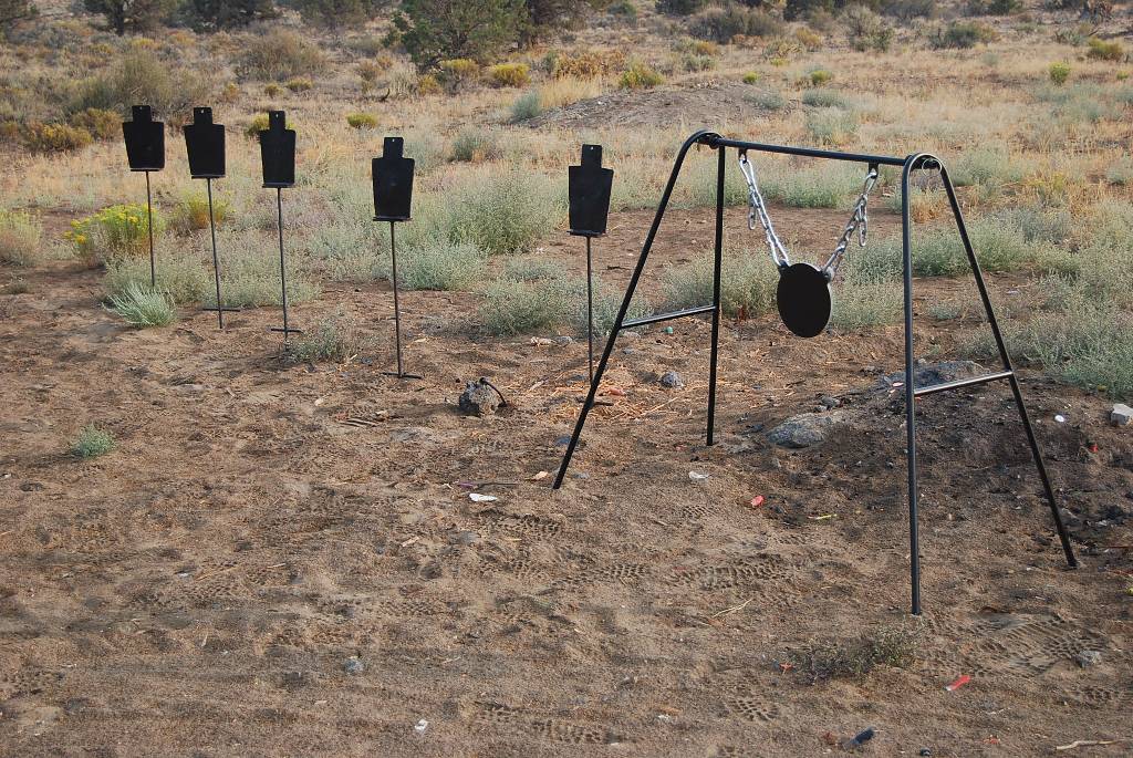

If you place the steel at an angle to deflect the bullet down, it really reduces the chances of any splash-back, but we still always wear eye protection just in case.
My other steel; falling plates and a swinger. We use caution here, as splash-back is still a concern:
