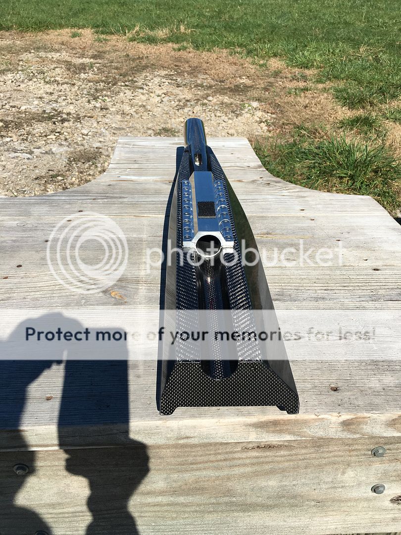

35 pounds as pictured without brake, trigger, scope, and IVEY rings

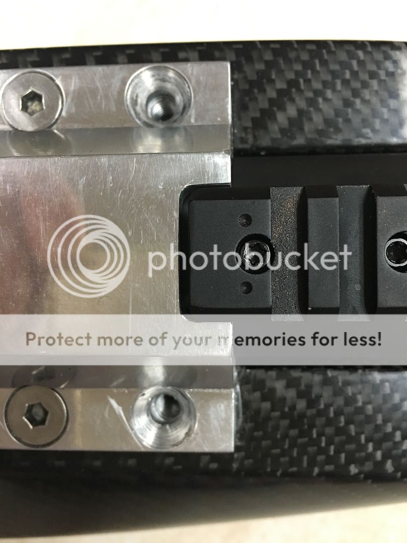

40 MOA Stiller rail

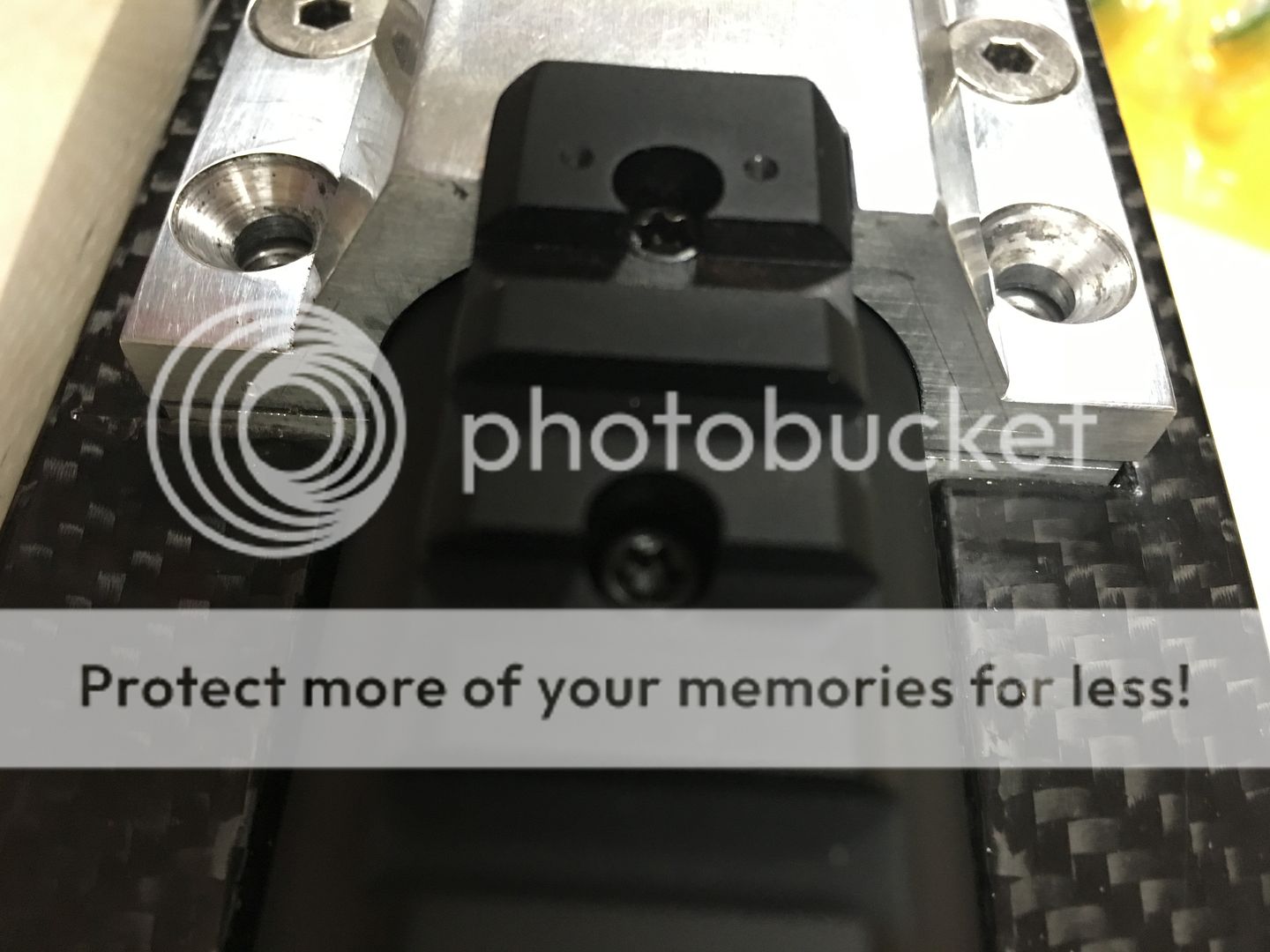

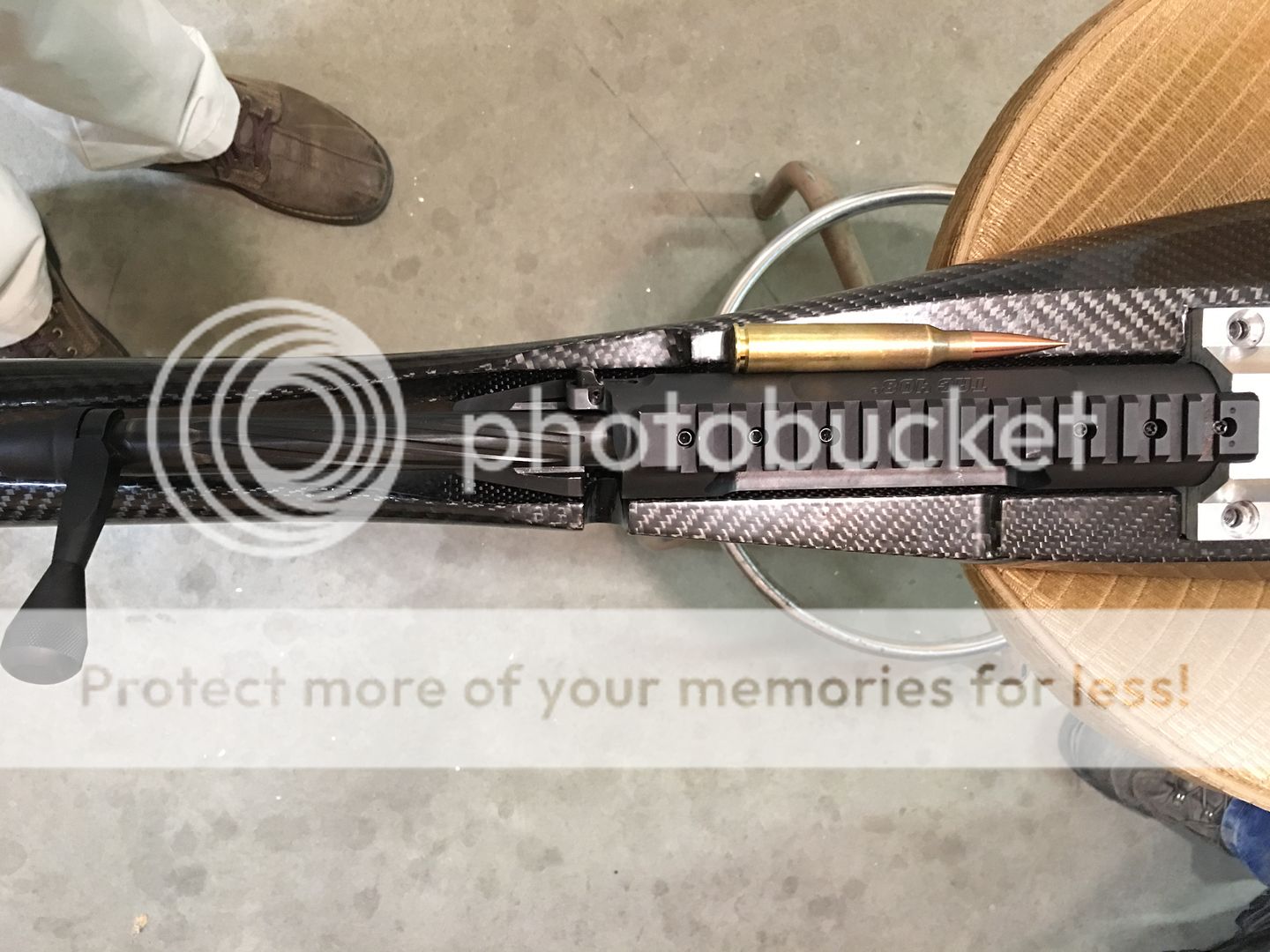

Modification to block for 10.5 in. action
action extends into block
