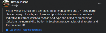

The low quality of the attached photo is unreadable when enlarged enough to see the smaller print. Interesting but .......
Not meaning to disparage your efforts at all. I appreciate your posting. Good info and I really wish I could see/use it all but print is to small for my eyes.
Another hard pass on Facebook.
I'm not sure what the data is supposed to convey.
I thought accuracy of smallbore ammo in a given rifle was lot dependent - irrespective of ballistic tests.
Wildcat is correct. Hundreds or maybe thousands of rounds shot for nothing. Ammo is single barrel dependent if your talking accuracy. Typewriter shooting gets more popular every day. Never for get....Figures lie and liars figure. That's what always comes to mind when I hear statistics.
In all of the statistical discussions I read, I have questioned for a long time, the assumption that shots fired in any test fall into a "normal" distribution. Why do we believe that. In my experience sometimes the curves look like they do, but often time not at all. Also, I've shot enough RF to agree with jelenko above - results are totally barrel dependent. If it weren't so, why "lot test"?
Stats are only as good as their inputs. This seems to be lost, factually correct info these days. A gazillion rounds fired in a bad test will still yield garbage. They have a term for it...garbage in, garbage out...GIGO!

I've seen some references that indicate a different (Rayleigh) distribution curve than the normal / Gaussian curve.
This is a normal distribution of point of impacts with non-biased radial dispersion of bullet impacting a target with SD of given Sigma.
What the chart is saying if you shoot enough rounds where the POI is driven by random processes. The radial distribution would follow a normal distribution with SD of Sigma, with 99% of all shots falling in a radius of 3x Sigma
Note if the MV or BC are considered as random processes too. The radial dispersion would become biased, and the MV and BC would make the dispersion vertically elliptical.
Similarly, if the wind is changing in speed but fixed in direction (say coming from 3 O'clock), the dispersion would be horizontally elliptical.
In all, statistical analysis and simulations (e.g. Monte Carlo Simulations) the user has to declare any input to be static or random. Thus, the more inputs are declared static (i.e. has a fixed value), the less realistic the analysis/simulation becomes.
I think the bigger issue is separating systemic error from random error, which a normal distribution is very good at modeling. Need lots of data and systems analysis for that.
If you dig deep enough, we aren't testing enough and we aren't using the correct metrics for evaluation, but ain't nobody got time (or money) for that (except the government, who wrote the book back in 1964).
