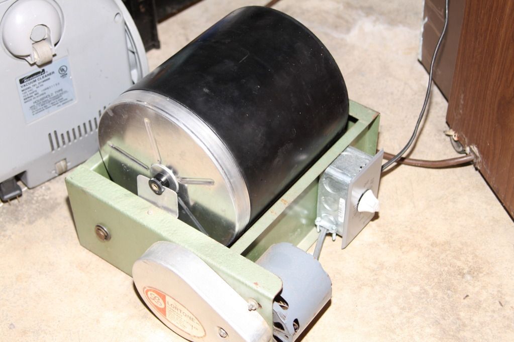

I use a standard speed Lortone rock tumbler and my brass comes out better than it does from the factory. Maybe it takes me a little longer because I don't use the high speed Thumbler, but I've NEVER had any damage to my cases. I really don't think it's the SS pins that are damaging your cases. It's most likely the other cases that are doing the damage. The SS pins do do have enough mass to damage your case necks. Pick up a new or used "standard speed" tumbler and you'll be good to go. I perfer Lortone. Thumbler would be By the way, I use 6-7lb of SS pins and then fill the drum to about the half way point. I then add enough hot water to cover all of the brass and pins. I know they say not to use hot water, but I highly recommend giving it a try. A teaspoon of dishwashing liquid and Lemishine and the brass will be good to go after about 3 hours.

I know Thumbler makes a standard speed rock tumbler and a high speed tumbler that seems to be the one everyone recommends for cleaning brass with SS media. I use a standard(low) speed Lortone QT12 rock tumbler.

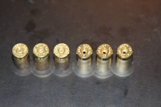

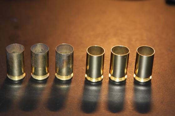

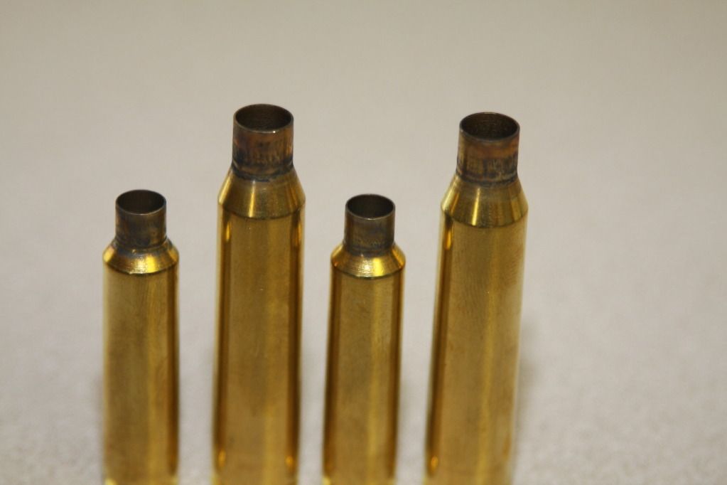

I'll try to throw in a batch of .338 Lapua and .284 WIN(mixed) right now and post some photos later. Just need to decap them first. I all of my brass with steel pins now, including my long range precision rifle ammo.
I'll try to post photos of the entire process.

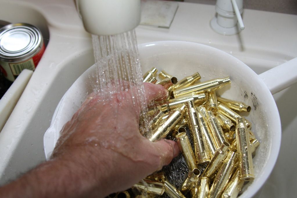

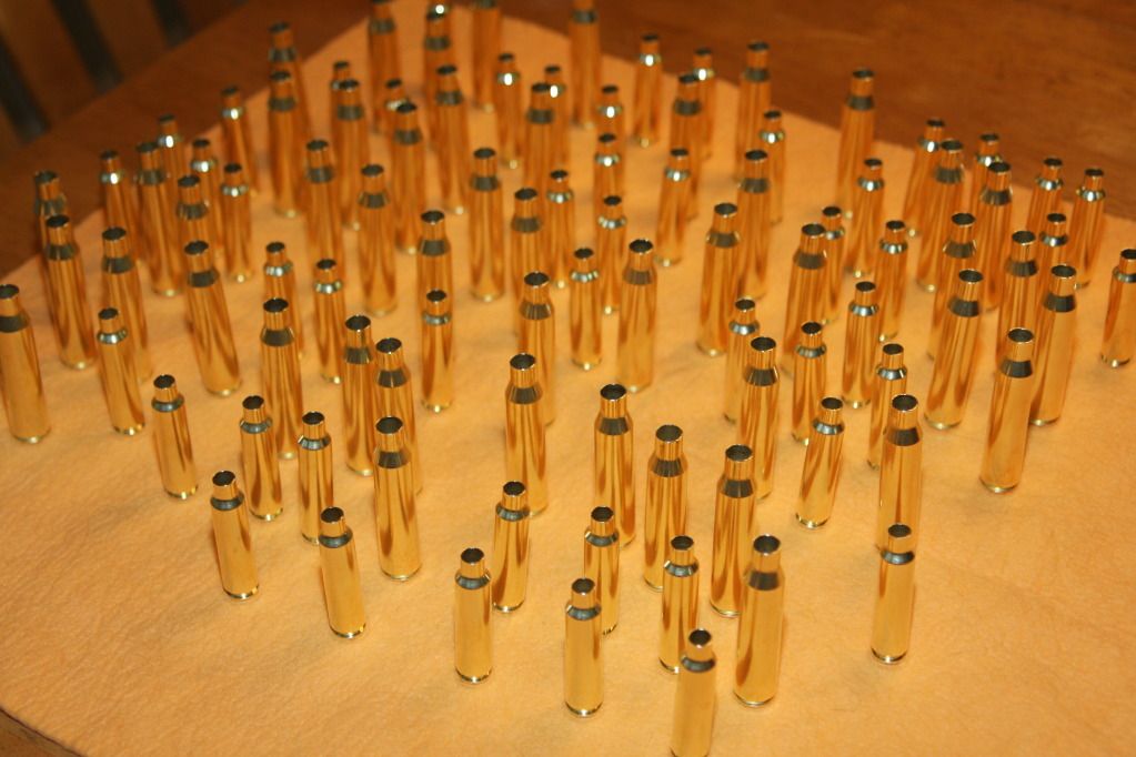

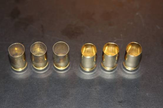

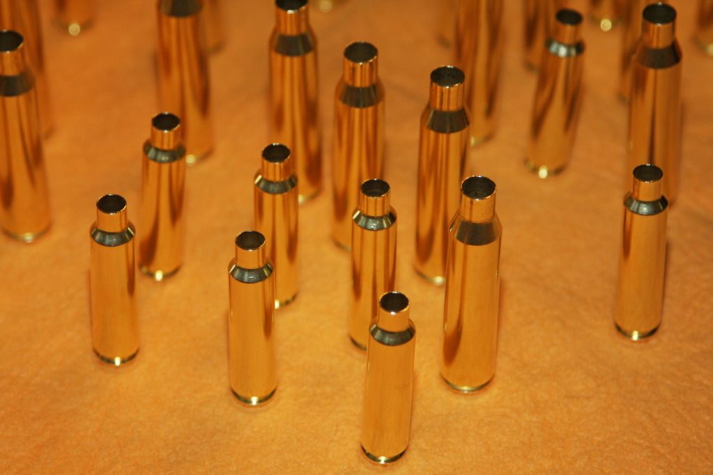

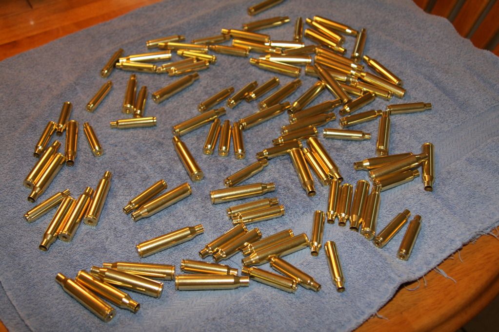

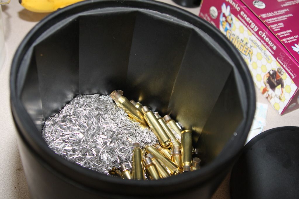

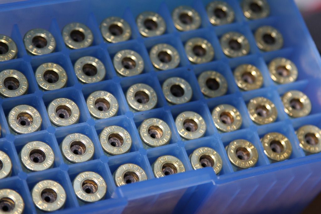

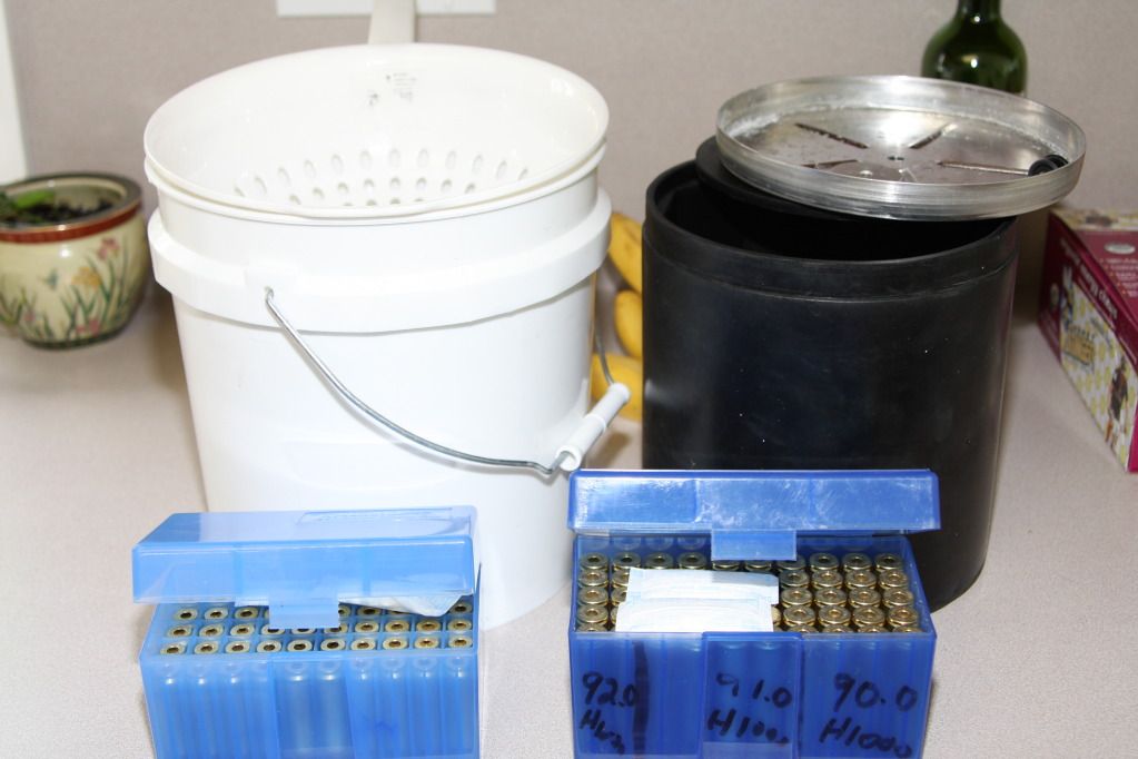

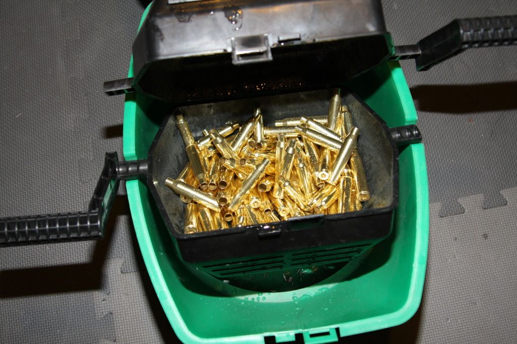

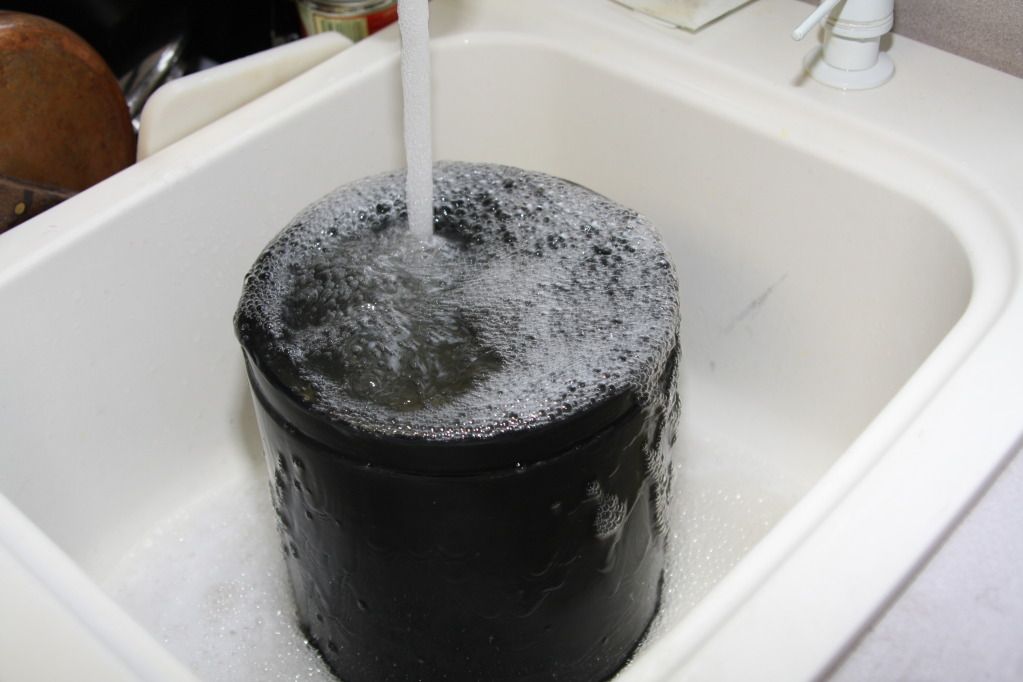

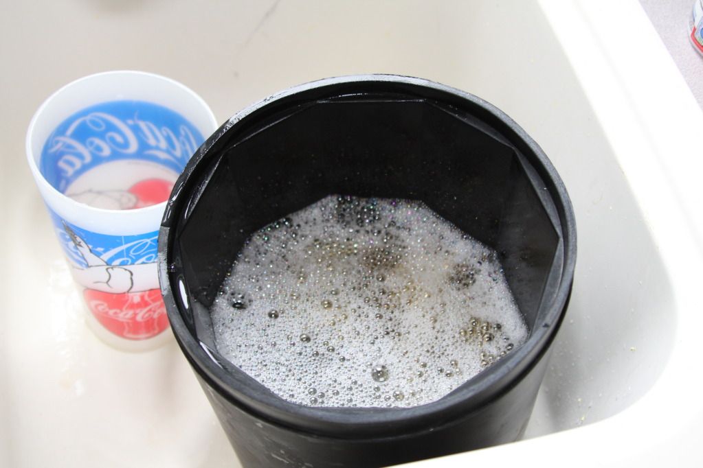

I normally clean more brass at one time, but this was all I had ready to go. The drum is normally filled about half way or even a little more with the brass and pins. I make sure to cover all the brass and pins with water. I used hot water and tumbled for about 2 1/2 hours. I rinse it quite a bit in the drum(until water is pretty clear), I then dump it into the colander and continue to rinse it while moving it around. Almost all of the pins end up going through the colander and into the bucket, but I still do a quick spin in the RCBS media separator. I roll the cases around on a bath towel to dry most of the excess water on the exterior and then stand up the cases on a shamwow(guess they're good for something afterall) to dry overnight.
