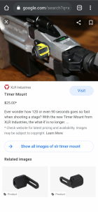

XLR has a sweet timer setup if your looking

A solution is made by XLR
