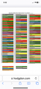

It would appear the StaBall Match is in the similar burn rate group as the Varget, BLC2, 748.

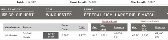

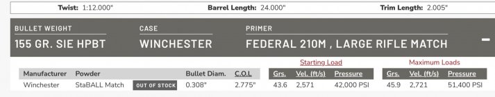

Curious if you can get enough ina 308 case to with lighter bullets. Seems you need more grains than varget. Just loaded some to check velocity and was surprised by how full the case was.
Good point. Looks like it could be a compressed load at the max.
Above is Hodgdon load data for “308 Winchester”.
Below is their load data for “308 Winchester Service Rifle”
