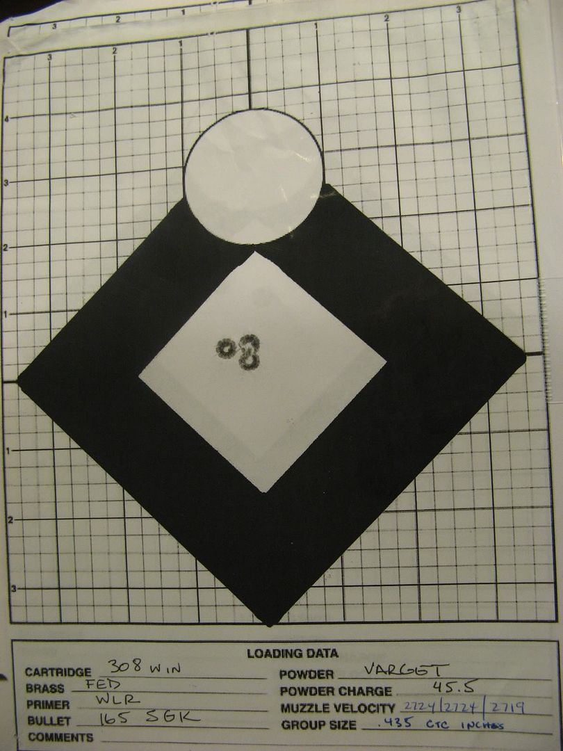

Mine touches the stock too, but focused more on the load development side of things to find it's true potential.
Here's one I'm fond of...
