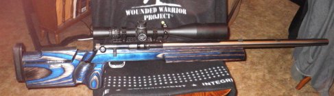

When I did my laminated stock, my final sanding of the wood was with 200 grit. I wanted to get it sorta smooth but also leave something for the finish to latch on to. Then I did my over sand with 600 grit. After the next coat, I used the 600 again. When that dried thoroughly I used automotive rubbing compound to finish polishing.
