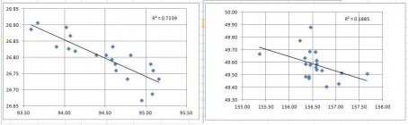

there are some posts out there that state weight sorting cases does not ensure same internal capacity. I checked this out and was happilly surprised to validate this information. Weighed 10 cases to get H20 capacity. Then went back and found the ones that had the same internal H20 and then compared the dry weight of the cases. Guess what......they were not the same. Varied as much as 2 full grains. So that shows me if I weight sort cases that really does not do anything for me except to cull out extreme variances
Just thought I'd share. Since at one point I sorted over 500 cases by weight. Now doesn't seem it would help all that much for me
I’ve done this experiment and posted it here. The answer is it depends. For example, there is an excellent correlation between brass weight and capacity for LC09 556 brass. However, there is a poor correlation between Win 308 brass and capacity.
The other unanswered question though is looking at the LC09 brass which has excellent correlation between weight/capacity, testing a series of cases which varied by as much as 1.5 grains, with everything being the same, I found a relatively poor correlation between brass volume and MV – correlation coefficient of 0.12 using 25 cases. ::)
This surprises me as I am pretty sure that changing case capacity by changing seating depth has a pretty significant effect even with minor changes. It is true that that method does change the distance between the bullet and the crown but still…. Wonder what other’s experience has been.
Thanks for the replies. I loaded up some using the middle brass or same weight. I notice (thought I noticed) some looked to come up to the necks higher and others are a little lowerer. I remeasured the powder thinking it was off, but it measured correct. Maybe this is the internal capacity variance....
Some time I will fill some up with power and separate the full ones and lower level ones then do the water test. Do you use water or an other liquid (alcohol) with lower "contact angle" to reduce the chance of air bubbles inside the case?
Thanks again
Troy
As mentioned previously, the Win 308 brass weight did not track real well for me in terms of volume. Here is my data for the 556 LC09 brass and 308 Win brass. The 556 is on the left and 308 on the right. X-axis is weight and Y-axis is volume. You can see the 556 correlation co-efficient is 0.7239 vs. 0.1885 for the 308.
In terms of how high the powder comes up the neck, it is a bit difficult as depending on the granule shape, you can have significant voids in there. You can decrease this a bit using a long drop tube or vibrating the case or tapping it. When I did the test, I put in a spent primer and used rubbing alcohol (70% isopropyl alcohol) which works well and does not evaporate that fast or leave a meniscus.
