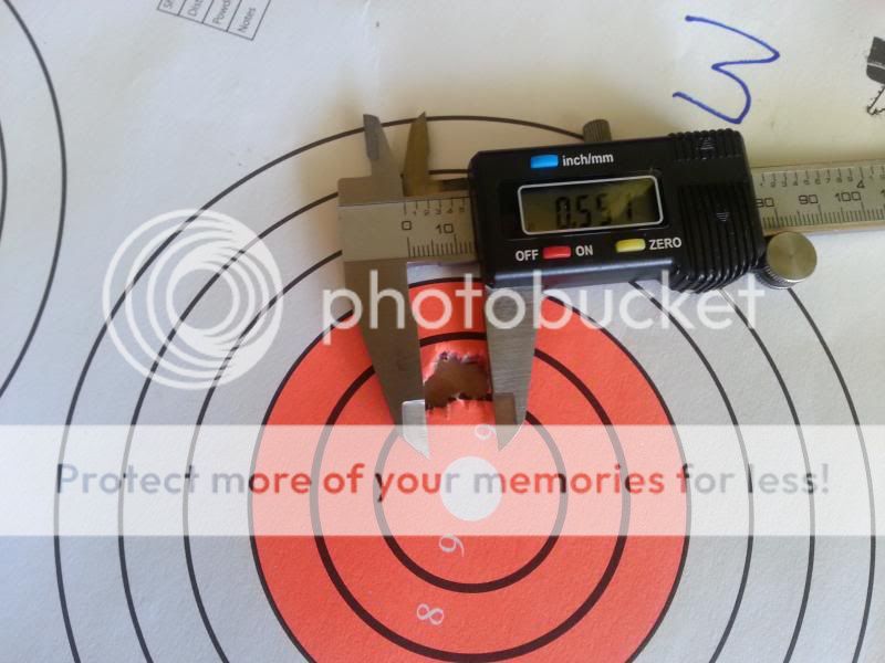

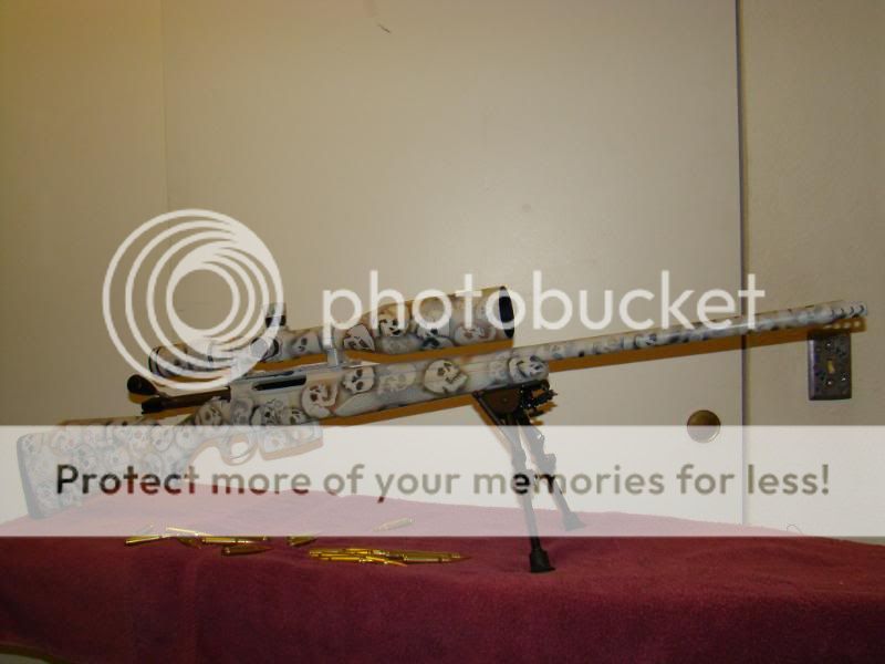

The Tikka below was my first precision rifle, bolt action. I choose the Tikka because of the Sako barrel and the butter like action. I make the claim that this was the last 308 Varmit sold in the US of A. Any how, this was the first load I developed when I took up this sport. It's 45gr of Varget in Lapua brass pushing a 178 Amax, seated 2.112 to the ojive or Tikka magazine length. The target on the top is the 5shot result of the load. I used that load for shooting in the local 300 yard palma match and to ring still out to 1200 yards. Up until now I have about 1700 rounds down the tube.
Well wanting to see if I could improve on a load now that I know a bit more, I started a charge test with the Varget and the same load produced the same results, as shown by the target from today. I will take this test a little further and load closer to the Lands and see if I can tighten up the group a bit. The tikka lands is about an 80 thou jump.

Last time out with this rifle at 300 yards, 15 shot group. Hey Butch, take a breath! LOL I don't have nothing to prove, it is what it is! the groups were shot more than 3 years apart. Sheeezzzeee

No Butch, I read it and I fly Commando so no panties here!! LOL, These were not cherry picked groups as you insinuated, they were just the ((5)) shot groups that formed up during development. The gun does shoot tight groups, next time out I will shoot a set for you.
