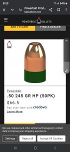

I went back out today. I tried the Hornady Bore Drivers and 100 grains. It worked well. 1600fps.
I fired 2 more with 150 grains. It also worked well. Recoil was more than I want to deal with.
Thanks for the help. This forum is the best!
