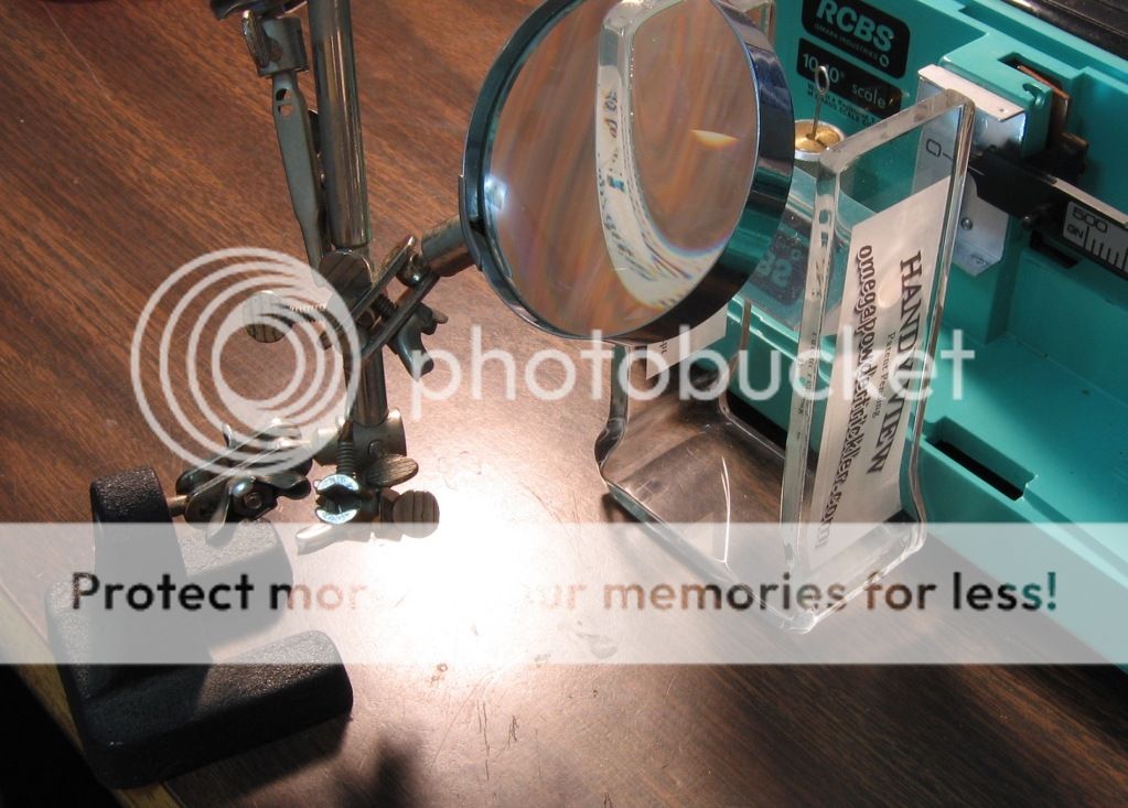

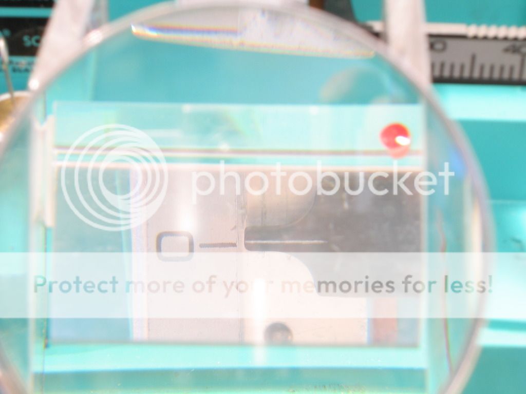

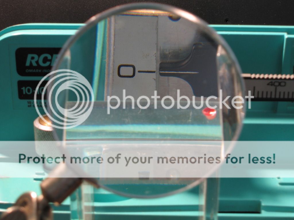

Recently I have posted on a thread that started out about a balance beam scale that is in need of a tune-up. Rather than post these on that thread, I have started a new one. After shooting the first three pictures and downloading them onto my computer, I discovered that instead of shooting through the magnifying glass and the Handy View's prism that my camera was too high and that I only had a shot of the image through the magnifier, so I reshot that one, but included the first version to show what a magnifier alone can do. Obviously with so many uncoated surfaces the image that is through both has much less contrast, BUT since its primary function is for alignment of the marks, without parallax, at a higher magnification, it will do the intended job. Comments, criticisms, and suggestions are fine.

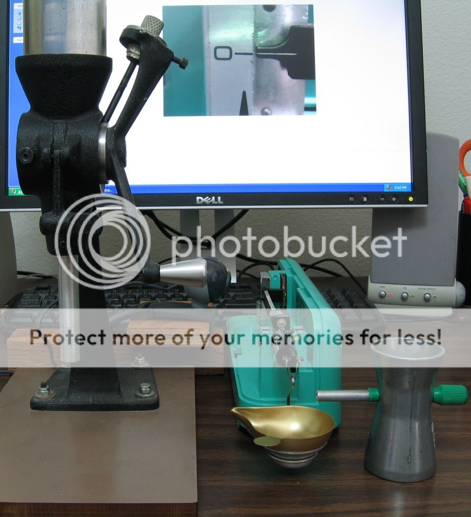

The issue is not focus, but size. If I balance the scale, and then set it .1 one way or the other, the amount of difference is small. If I have a magnified image, that small difference is much easier to detect. The best view is on my computer monitor. The others are quite a bit better than just looking at the scale. At the distance that I am working at, I don't need my glasses. Closer, I do, as well as some distance farther.
Has anyone tried a "webcam" and using their PC monitor for viewing?
If I go back to using my beam scale, I just might try that. Logitech has one that will focus down to 3.9". I'm sure there are others out there that will do likewise.
Look around on Ebay. I looked on Logitech's web site (the brand of my manual focus webcam) and they may not be making manual focus cameras any more, but some of the older ones are still available, for very reasonable prices, on Ebay. Mine will focus down so close that the lens body gets in the way of illumination of the subject. If you look at the top picture of my first post, it shows what you are asking about. Of all the setups it is the best, because of the image size, sharpness, and complete elimination of parallax. I did not come up with this idea, I saw it on YouTube.

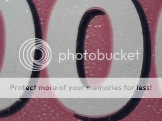

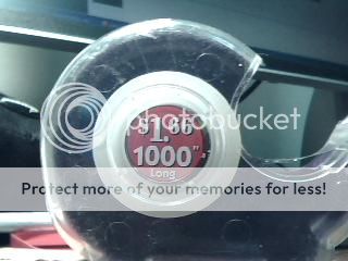

If this works out, the first picture is with the lens barrel almost touching the object, and the second one is from about 4" back.
