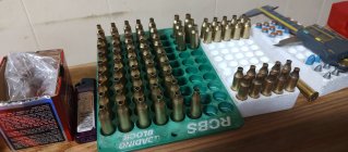

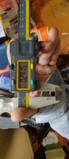

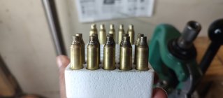

So tried using a .223 die for stepping
Wolfdog91

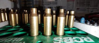

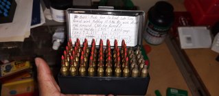

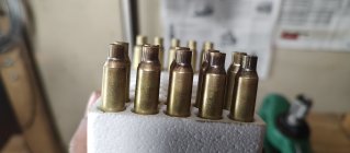

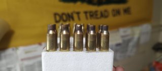

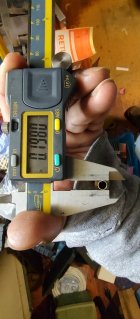

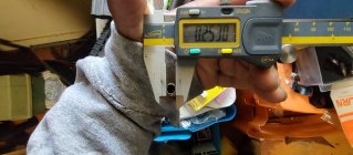

So a couple of y'all reccomended I try step sizing but instead of going crazy with a bushing set up to just use any .223 die I had ,get it and use it as a step for forming my .17-5.56 kak brass and gotta say sai far its worked PERFECTLY with about everything ive tried . Once fired , once fired annealed once fired super annealed, ha et tired new yet but this really was a bit of a game changer ! And cheap :).....now I have to find somewhere to put all this brass lol
Got one more showing how I annealed the brass with the whole dark room glow method but it's still editing.
This whole little deal just keeping getting more and more fun. ! :D
And some pictures
