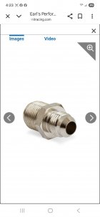

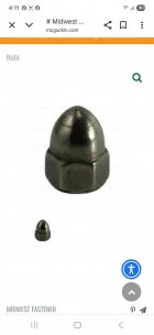

Boyd, I ran into a similar issue with 6.5x55 Brass. I think I got scolded on this forum for asking about a fix for my obvious over pressure issue. Anyhow, I sectioned some pieces to inspect and measure. Mine were as new thickness near the base. I tried the ball bearing trick and wasn't getting good results. I ended up using a Stainless flair fitting chucked in my Vice.
I use a undersized diameter punch wrapped with painters tape to protect inside the neck. It takes a bit of practice with the hammer as to how hard to hit it and how many times. It has worked really well for Mine. I have fired them several times now without having to re-size the pockets. This is the only caliber/ lot of Brass I've ever gotten loose pockets.
It'll work.
