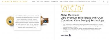

As I said above my .069 decapping pins easily fit my Alpha brass with a lot of room to spare, which supports when I read on their website that apparently shows them using .080" flash holes (one of the reasons there's been issues with piercing primers):

Only their ppc is the .060 all the other srp brass is.080

The 7-08 brass I have is .080"
