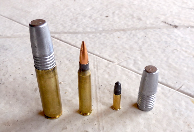

I'm an ammateur for cast stuff but I've used the 45/45/10 on a 50-cal wildcat with a custom 700gr mould up to about 1300fps:
