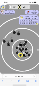

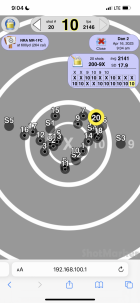

In fact, I have two, my light gun and my heavy gun. I started with Savage PTA and a semi finished stock from
Sharp Shooters Supplies. I have a wall full of ribbons proving the guns' viability!
I did all the finishing on these guns as well as pillar and glass bedding.
The main complaints for these actions are the availability of triggers. First, the precision Accu-Trigger is not as bad as most people think it is. I put a trigger made by Sharp Shooters Supply on my light gun with excellant results. Unfortunately, I think this trigger is no longer available.
