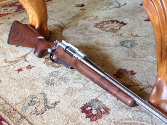

Click on preview for bigger pics
Consider the 160 Tippedkings.
My only 7mm08 is a light hunting rifle but made me think twice and am pondering a 7mm08 Improved for f-class in the future. Mainly for the extended barrel life.
