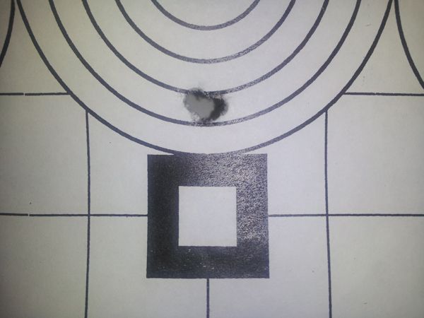

Just an update:
I worked up a pretty sweet load in my 22-250 over the holiday weekend. I used a starting load of 36.5gr of IMR4320, and worked in .5gr increments up to 38.5gr where I started to get heavy bolt lift. I found a node between 37gr and 37.5 gr, then I loaded up a few at 37.3gr and shot a very nice cloverleaf. I seated the blitzkings till they just touched the lands. i was going to stop there, but I thought I might try to turn that cloverleaf into one ragged hole. Working in .01" increments, I moved back until I hit 3.095" OAL, using the hornady tool. Bingo! A nice, one hole, group appeared. Thanks for the advice guys.
