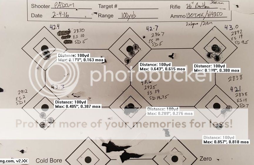

I tested these in my 26" Bartlein .260rem. Accuracy was excellent but I would only use them if they are all you can get your hands on. With their low BC compared to ELD-M, SMK, Scenars, Bergers you can gut a much higher BC bullet for your money.

i found my node at .085 jump using the 168gr TMK's
