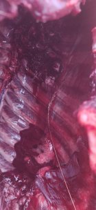

Not the 130, but I used a 77gr TMK from my 22creed this year and dropped a whitetail in his tracks at about 140 yards. No exit.
