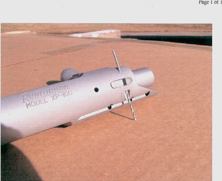

Hey fellas, does anybody know how to machine the action and make the stop for a remmy. Pictures would also be great but I'll take what I can get. Thanks guys, SPM

I was talking about the "rocker" style bolt stop/release. The spring plunger style are simple, just a dr/tapped 5/16-24 hole with a spot faced flat in the appropriate place.

Wally Heart makes a "presto" style bolt stop that is knurled and round,rather than looks like a bolt head!!)..and it is installed in the bolt raceway like the one Donovan told us about...I have used them for 30yrs ..no problem...Roger
