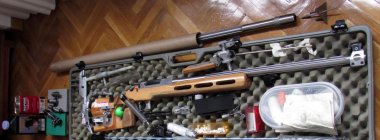

Mine is intended for 3x40 and Prone at 300 meters.
Unique T3000 in 6.5x55, very close to 8 kg. Two barrels, one for training, Pac-Nor 1:8", 4 grooves and 9,204 shots, still accurate; the other is also Pac-Nor 1:8", 5 grooves and 2,236 shots, just perfect.
