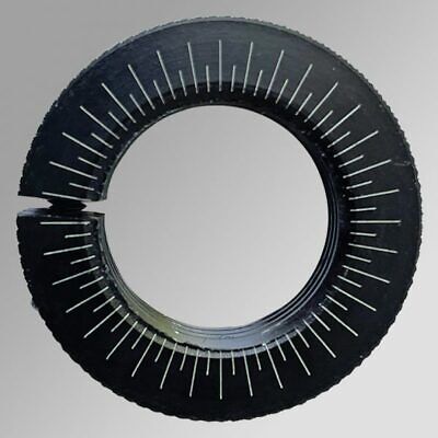

Every sizing cycle. Brass that’s been fired a few times may need the die screwed in more. Brass that’s freshly annealed may need it backed out.
Forster lock rings with the .001 hash marks are EXCELLENT.
Those look fun I can’t believe I’ve never seen those before. I know there’s some benchrest dies that have clicks for loading on the line when they can’t anneal. But for 10 bucks this would be nicer than using a sharpie. Good find thanks.
I love them. A little sharpie mark on the die body for “zero” and the marks are true .001 increments.
I’ve also noticed that the lettering on most dies is worth about .001 per character…. If you have a die you don’t want to upgrade.
