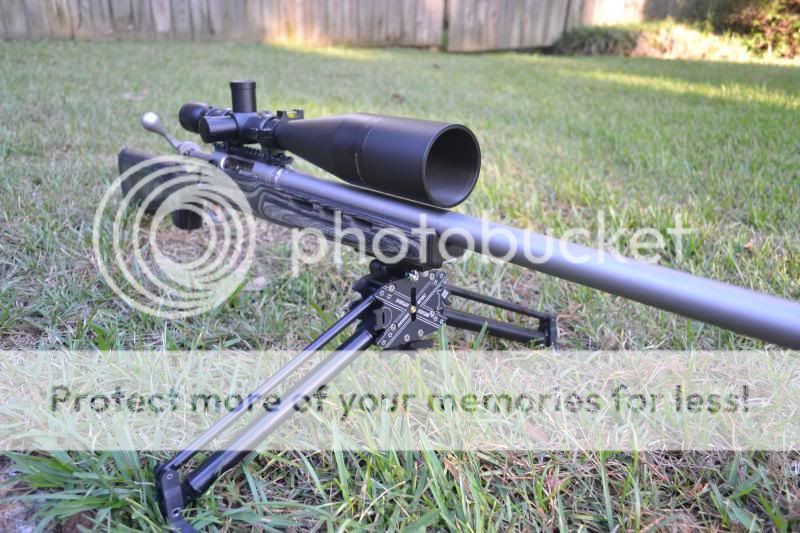

and the rifle
Going out tom or Friday to do some load development with the 175 SMK so I hope it will shoot just as good for me. This is my 600/1000 yard FTR gun.
*Sightron S111 10-50x FCH scope
*EGW 20 MOA base
*Burris Sig Z Rings 30mm High model
*Duplin bipod(this thing is freaking lite)
*Savage stock FTR 308 win
*Sinclair Anti cant device(scope mounted)
