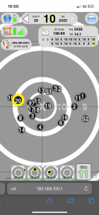

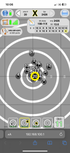

Shot my first F-Class match 300YD
Some back story:
I've been participating in PRS matches since OCT of 2023. I've been trying to get my dad into PRS but as he's on the older side he never quite got into it. I found out that a local club (SBRGC) has a 300 yard F-Class match. He was interested and so was I, we shot the match yesterday and it was very fun! Way different shooting discipline than PRS and VERY humbling.

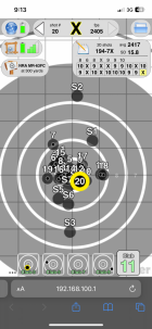

Here are pictures of the targets I shot yesterday (60 round match). These were all shot off a wiebad rear bag and ckye-pod (other than the 3rd picture where a local competitor let me try his Lenzi bag, Thanks T!)
I'm definitely looking to shoot this match every month with my dad as he enjoyed it as well (bonding time is the best time)
I think I'm going to continue to shoot the matches with a bipod and rear bag as F-Class is more of a secondary discipline to PRS but my dad really enjoys this sport, and is looking into getting a beginner front rest and rear bag.
