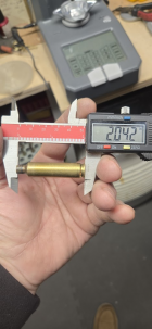

I just read through all of this again and decided to go pull some 243AI fired brass. Here are the dimensions.
Here is after sizing with 243 Win 40deg Impr dies.
I will have to post again to show 243Ackley Impr die measurements do to pic limit.

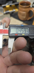

After using 243Ackley Improved sizer dimensions
If you notice 2 things here
1. The shoulder oversized the brass on the 243 Win Imp dies.
2. The case length grew more with the 243 Win Impr dies.
On a side note with doing this I noticed. Now I was able to get both dies to set the shoulder back to the right depth. Difference from when I initially chambered this rifle years ago was that I am using different sizing lube now and stuck cases in the die are no longer an issue. Before I constantly stuck cases in the 243Win Impr dies which led me to the in-depth search and discovery of the shoulder oversizing. I used many of the popular lubes trying to get it to quit sticking cases. Now I use alcohol and Lanolin 10/1 ratio mix and it is amazing. I also anneal every firing. These 2 things make a world of difference. Before I could not size the case enough to bump the shoulder.
By the shoulder dimensions you gave earlier it appears you sizing die is not over sizing the brass like mine did. You said yours is sizing to .4589" which is about the correct reduction for an Ackley shoulder to be sized down. May be a different issue.

Interesting. My shoulders are coming out .4575 to.458. That website graphic showed .4589. Was wondering why you're using the A3.30 comparator instead of D400. Thanks for all the input. Think I'll have another 0.010 taken off my die and see where that leaves me.
Just had it on. Its not what I use to record it so doesnt really matter. Just needed a reference point to show difference.
Was just reading over at 6mmBR.com. The author is saying the Ackley improved die gives you a 0.460 shoulder and Win Improved die gives you a 0.455 shoulder. With my Win Imp die, after annealing, mine are pretty close to 0.455. I took another 0.010 off my die for a total of 0.020 and now i can shoulder bump. I'm now sold on annealing. Tough cases that I couldn't push the shoulder on pushed back easily after annealing.
From 6mmBR.com:
"One thing that you need to watch for is what version of the .243 Improved that you have. This depends, for the most part, on whose reamer you will be using for the chambering of your barrel. It is easy to determine if your .243 Improved is the .243 Ackley Improved, or the .243 Winchester Improved. If you have the .243 Ackley Improved, the shoulder-body section will measure .460" dia. at this point. If you have the .243 Winchester Improved, the shoulder-body section will measure .455" diameter at this point. Both cartridges have the 40-degree shoulder. I have used both versions and found that you can use any data developed for either version interchangeably."
