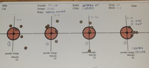

I was able to reproduce the videos results. Targets 1-3 were all the the same load, the butt positioned tight up to my collarbone - same verticle stringing. Follow thru sight pic was well to the left of target..
Target 4 same load (albeit with 0.005 shorter BTO measurement) much tighter groups. 100 yards. Semi auto 6 ARC. Same brass lot / batch. No / light wind. But soft shoulder, butt in the "pocket" lightly agaisnt the pectoral "meat" allowing best as I could for straight rearward recoil. Follow thru sight pic was much more on target.
