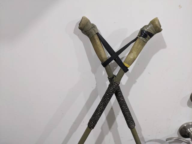

I've been using fiberglass fence "markers" (1/2-5/8" x 5') for years. They're lashed together with paracord prusik knots. I've used heat-shrink tubing to keep them from rattling, but my fanciest ones have a section of radiator hose on the ends. A lot of the kids I deer hunt with drag bog-pods all over the place with them. My sticks weigh a couple of pounds and cost around $7 a set.
I made a set of these before I found this pdf. You can even make them out of carbon fibre arrows. Weight only perhaps 3 oz.
Don't leave home without them
I prefer this perser knot to castration rings.
