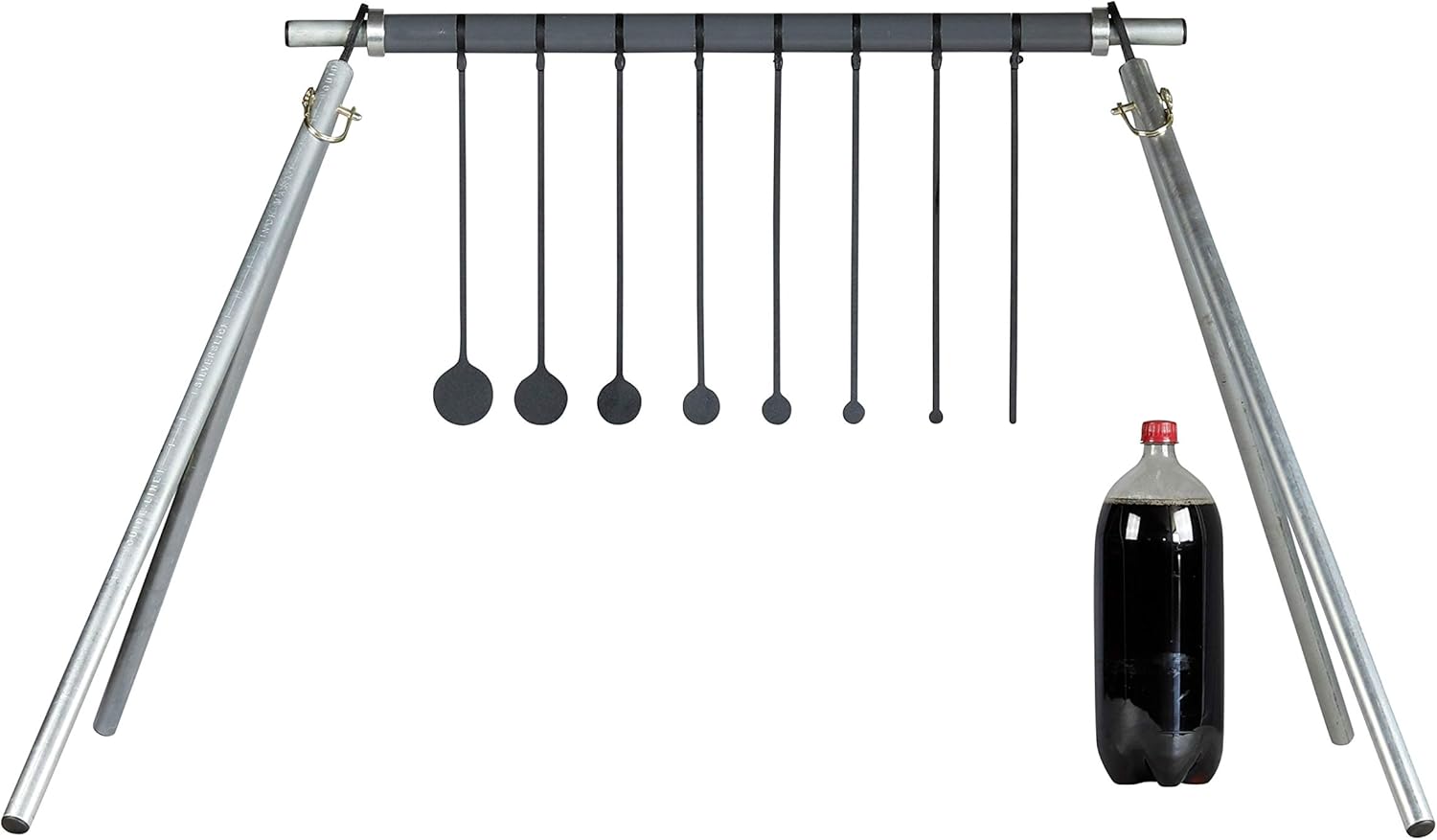

I'm hoping to setup a Know-Your-Limits .22lr target at perhaps 110 yards. Does anybody have experience with how far the splatter will travel, when shot with a .22lr? How large of a space-safe would we need to have?
Image of the KYL target:

Assuming you hit the spinner, any splatter is down because of how easily they swing. I've had a USPSA carboard target to the side of my KYL and haven't noticed any damage to it when shooting.

At 110 yrs you don't have to worry about 22 rf splatter. Your swinging target or stationary one's at a downward angle would deflect any safely.
