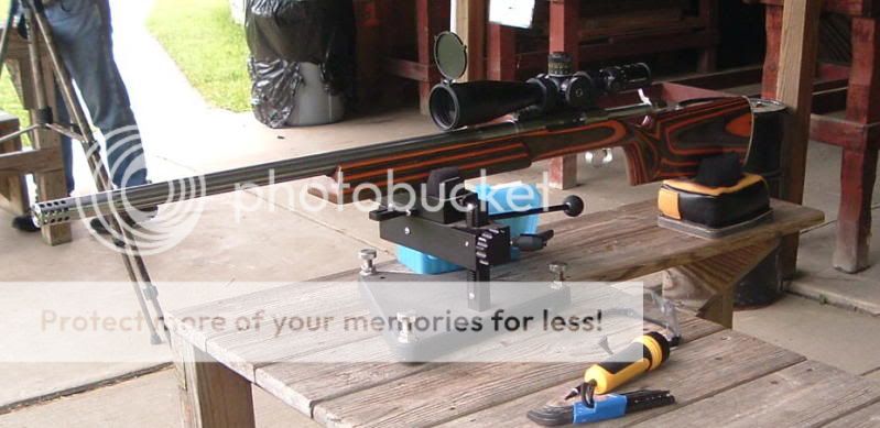

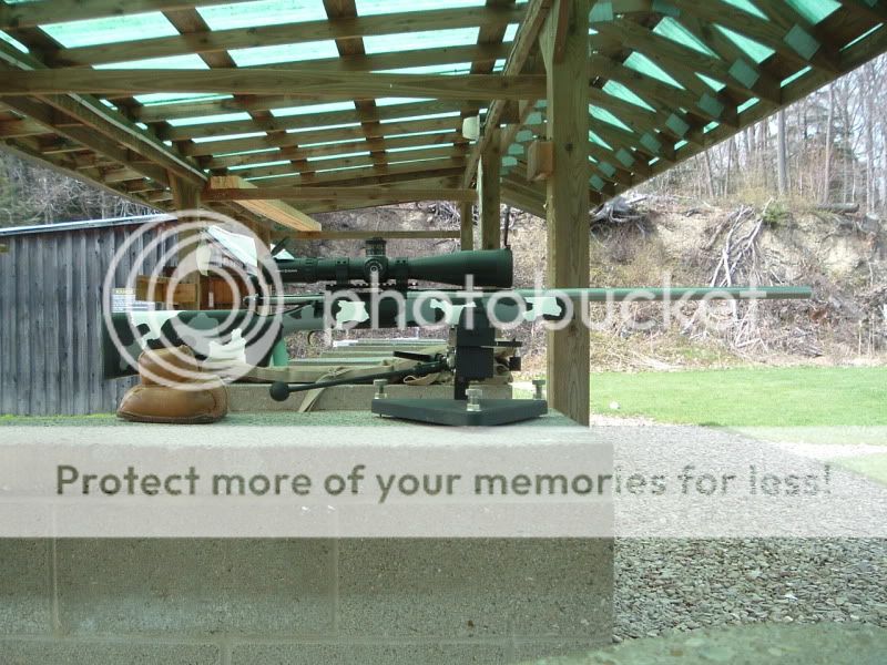

HRB woodchuck gun.
and
17 pound 1000 yard light rifle.
http://www.benchrest.com/magnummetal/toggle.html
