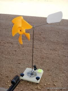

You could make yourself a windmill station like they use in smallbore competition (catches wind directional changes and shows angle).
