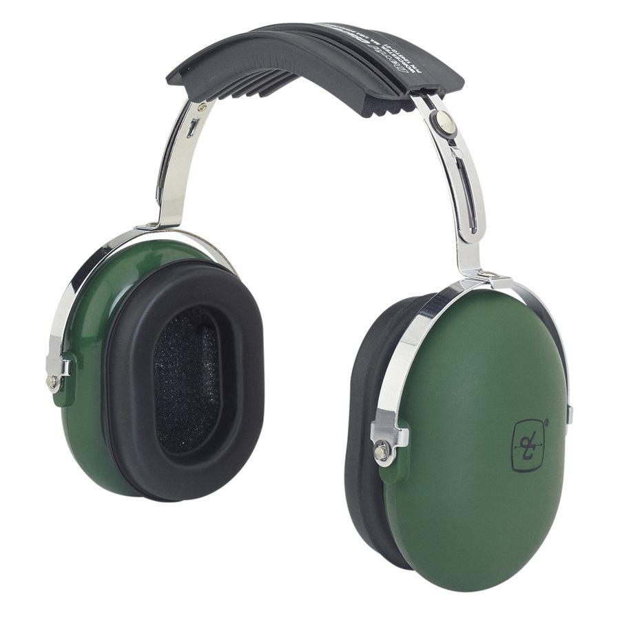

You need good ear protection on a covered range. I like David Clark's muffs. You can replace the foam filled cushions with liquid filled cushions for more comfort. I still wear foam plugs with them.
