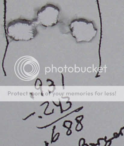

For a weak Berger 68 gr. FB load (45 gr. H414) this one shows promise, I fired three goups with it all about the same, I'll be working up a load with this bullet for 100 yard shooting.

The groups today are nothing compared to what many of you guys shoot, but they were much better than I got with the factory barrel. The 85 SGK Federal load shot really well, I liked it in my factory barrel also since it would shoot around .8" pretty consistantly. In the LW the very first group was this .35" at 100 yards off the wobbly benches at ASC in Houston:
