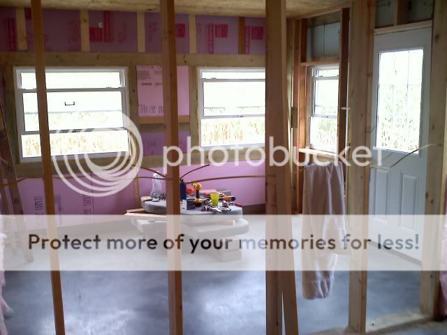

Pic 3
Just a pic of some of the progress during the building and insulating of the shoot room

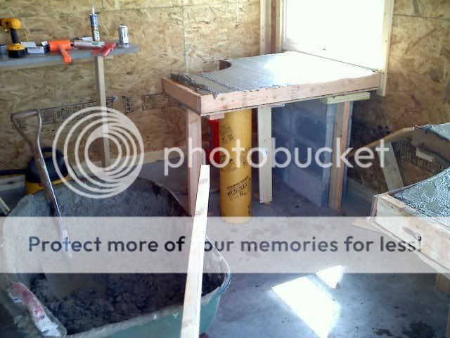

Here is a pic of my benches. I set the block in mortar then formed the tops in place with some t suports to holt the forms up. i used an 8" sona tube for the rear leg. added some rebar for reinforcement. Worked out really really well.
Pic of the pour in progress
Pic of me troweling the tops.
Here is a pic of the top poured and set up. notice how the forms just drop straight down. Very easy to strip.
As you can see the rifle fits very nice on the bench.
