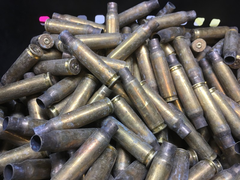

Before

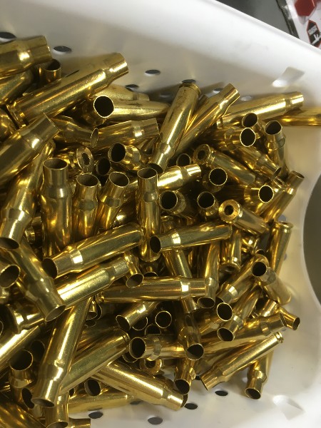

AFTER 1-1/2 hours
I tried tumbling some old 45 brass that looked pretty bad with corncob media and although it came out OK there were some that had tarnish marks on them still . They were clean and smooth ( very reloadable ) but not clean like the wet tumbling does .
I was looking at the directions posted and it appears your tumbler is pretty small . 3 or 4 pounds of brass is not very much . Most of these type machines capacity is based on weight . Yours does not hold much weight it appears . After adding water and pins to my F.A.R.T I can still put 300 -308 cases in it . I think it's max is 20lbs+ they claim 1k pieces of 223 . I've never done that many but think I've done 600+ before .
