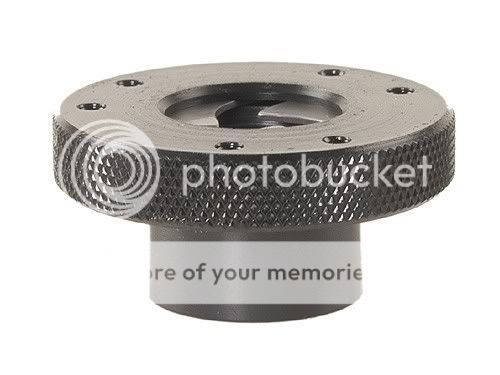

Just a FWIW from someone else who has the K&M setup... get the RW Hart case holder / driver.
I've used the K&M to turn a few *thousand* case necks. I don't have the strongest grip in the world, but not exactly limp-wristed either. Short of taking a wrench to that driver that K&M supplies (wild guess, thats why it has flats on the sides) its hard to get it tight enough to keep the cases from turning.
I got a collar made by another K&M user that fits around the case holder and provides a knurled ring about 2.5" diameter that makes it much easier to tighten/loosen... used it for several years now.
About 6-8 months ago I was showing someone how to neck turn, and the 1/4" drive shaft on my K&M driver *snapped* clean off. Guess a few too many cycles of reefin' on it to try and get it tight enough finally took their toll. One thing led to another, and I ended up fishing an RW Hart case driver out of the drawer and once I remembered how it went together (uses a regular shell holder, not a Lee) I had it working and I'd be dipped if it doesn't lock up that case tighter than a drum, with a fraction of the torque required by the K&M. Finished out that project, and most of the way thru another now using the Hart driver and man is it nice!
