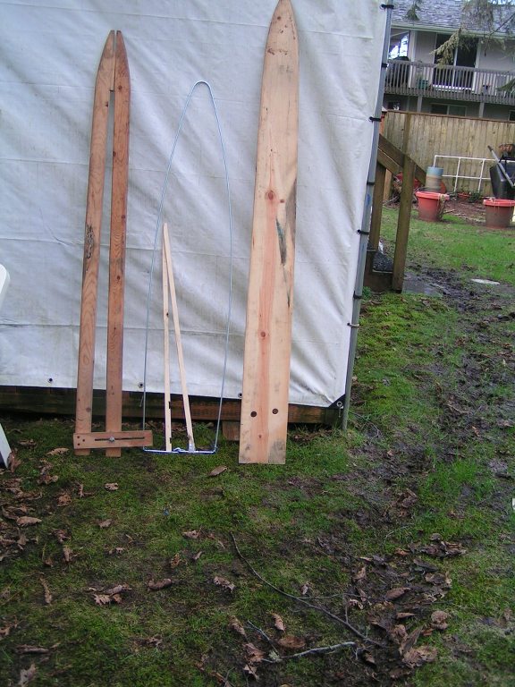

To sell pelts at auction or hold them to sell them you pretty much have to prep them. Cleaning, fleshing and stretching. The better your pelts look the more money they are worth. There are a number of tutorials available to show you how it is done. Also there are shapes that the fur buyers want that's why there are dimensions for stretchers.

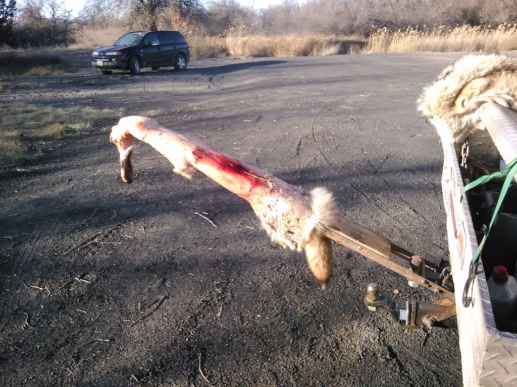

I just built a fur shed(just a tarp over a frame alongside the garage, when I was living in a tent I had a tipi that served as a fur shed up in WI. The past few years I've fleshed out in the field and just hung my pelts in the trees out here on the desert as my pelts were going to the tannery instead of auction. I'm going to start sewing fur.

Fleshing out in the field

Different types of coyote stretchers, the wood one on the right is too narrow it is just for tannery stuff.
