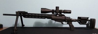

Tikka TAC A1 6.5 creed and two different lots of factory Norma 143 target using some target that only had one hole in it. Loose red dot groups are testing two lots (2+1 groups), no tuner, brake, or can. All 5 shot groups. I put a tuner on it and the three center groups are with tuner. Top one I just screwed it on and still at 0 (that works), the other lot at 0 is the bottom(no go), I tried 4(better) and that's the one in the middle.
It was shooting one ragged hole until recently so I chono'd to verify it had sped up (it did) and then used the tuner to see if it would pull it back in. I'd say that's a yes. I had the same issue with my handloads, so I loaded up a short ladder to see if lowering the charge will pull it back in (without tuner) and will check that this weekend. Apparently the tuner was worth the purchase if only to simply check if the issue is harmonics.
Anyhow, yeah for a factory rifle it shoots pretty nice and I have yet to meet anyone with a Tikka that has seen otherwise. All the folks I know of with the TAC A1, they all shoot one ragged hole or better, regardless of caliber.
5 shot groups below before speedup, same factory ammo or maybe when I was working up handloads.
View attachment 1540936View attachment 1540935
What kind of tuner are you using?
That's an Arken EP5 5-25 that I got with a combo pack when they had a code to get it for free? 34mm Rigid Precision Mount - 20 MOA 1.5" (the EP5 is a brick, but it holds zero fine so I leave it on it)
I wanted a tuner that I could screw on behind my can, the cap, or a brake. If you don't have any shims, order a shim kit as you'll it for anything where the barrel threads have a relief.
Adaptive Tuning System (ATS) - SLIMLINE / HUNTING - 5/8x24 Threads - Black Nitride × 1
The bipod is a GRS Bipod & Adapter Set, however note that top mounting requires milling one more slot at the end of the forearm which I just got my local machine shop to do. Love this setup.
I have a full length arca rail under it. Be warned, between the rifle and the scope it's heavy.
