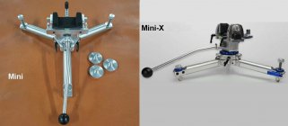

SEB Mini vs Mini-X
Seb Mini is for 3" wide guns,
Mini X is adjustable for forearm width.
I have a mini which I converted to a mini X style by using Fclass products Mini Mod Top. That way it will accommodate my 3" fore ends as well as standard hunting rifles. The end plates slide on the top, and are locked in place by the levers.

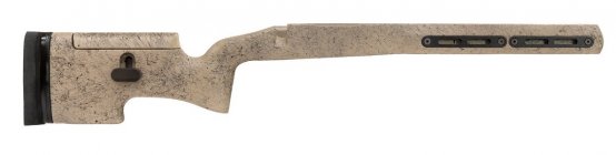

Sounds ideal. Would the Fclass products Mini Mod Top adjust down to accommodate a 2.5" forestock (my Grayboe Ridgeback). grayboe_Ridgeback_stock_brown-with-black-web_no-barrel-or-action.jpg
