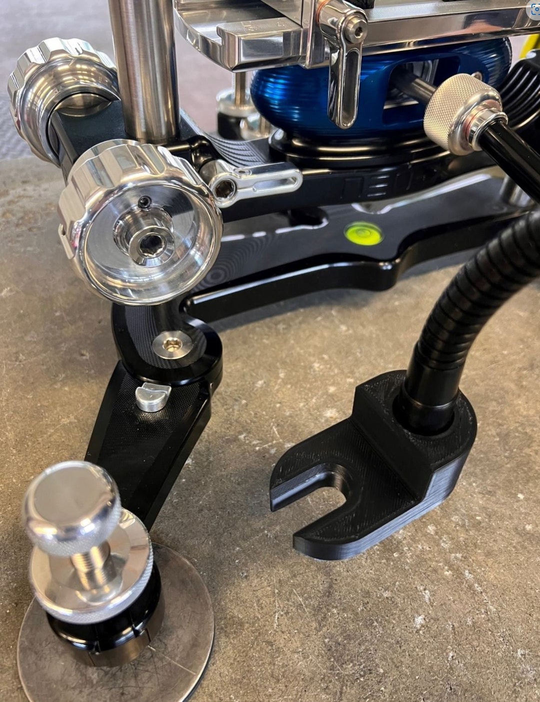

IMG_4239.jpegI have a Neo, but I just notched a piece of flat steel so I can chose what leg I want it on because I shoot left and right port guns. Then I just drilled a hole in the steel, so the mic stand has a place to bolt. the actual ammo caddy can be bought on Etsy. the thread adapters and mic stand, it’s self came from Amazon. There’s a guy on Etsy who sells this ammo caddy and tells you what you need from Amazon in his description.
View attachment 1462399I have a Neo, but I just notched a piece of flat steel so I can chose what leg I want it on because I shoot left and right port guns. Then I just drilled a hole in the steel, so the mic stand has a place to bolt. the actual ammo caddy can be bought on Etsy. the thread adapters and mic stand, it’s self came from Amazon. There’s a guy on Etsy who sells this ammo caddy and tells you what you need from Amazon in his description.

@newbieshooter gave you exactly what you need. I have two of them and, along with the proper length gooseneck, work perfectly and are fairly inexpensive.
I've seen magnets on the flex shaft to attach it to the rest. I've got one of the "Z" shaped shell holders it won't hold 30 cal. I've got to get it opened up some.
What a great suprise this morning. Perfect solution for my problems. Will get to work on this today and post results and pictures for other folks to see.
