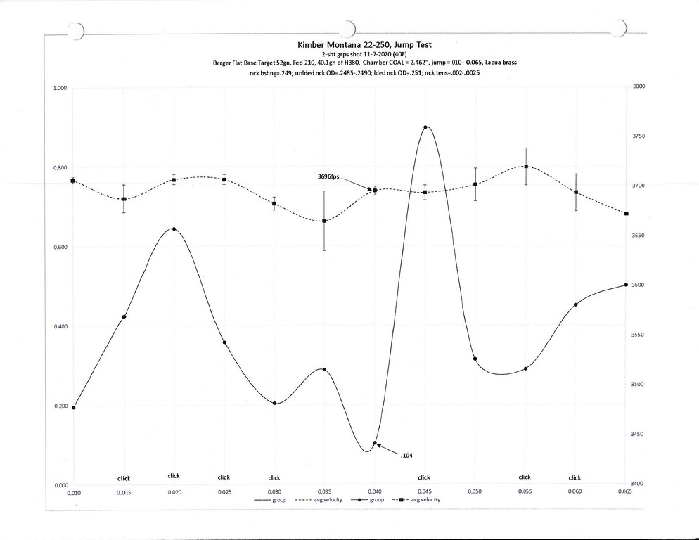

How many??? Only need to fire them until you find the tight group(s) and it begins to open up so you know the size of the window you're dealing with. Like one I did this last weekend where I find I'll have to retest a load/seating-depth (like the 43..4 and 43.6 in the pic below).
I like to use 3 shot groups, though sometime I feel 2 is enough), but I'll load up 4 or 5 of each load/seating-depth just in case I pull a bad shot so I can fire another to be sure to get a result I have confidence in.
