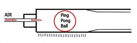

I believe that the function of seating adjustments to result amounts to a bullet-bore interface.
That is, finding an optimum bullet-bore interface.
To picture this, think of ping pong balls interfacing with a lotto exit tube. Some zip right into the tube,, some rattle around the mouth of the tube a bit. I believe there are optimum distances to release the ball from the tube.
Even though coarse seating results are independent of barrel or powder tune, changing seating depth affects tune. And it can move tune to a place that is not the best -in potential. That is why you should never do full seating testing from a tune. You should do it before tuning, as a prerequisite.
