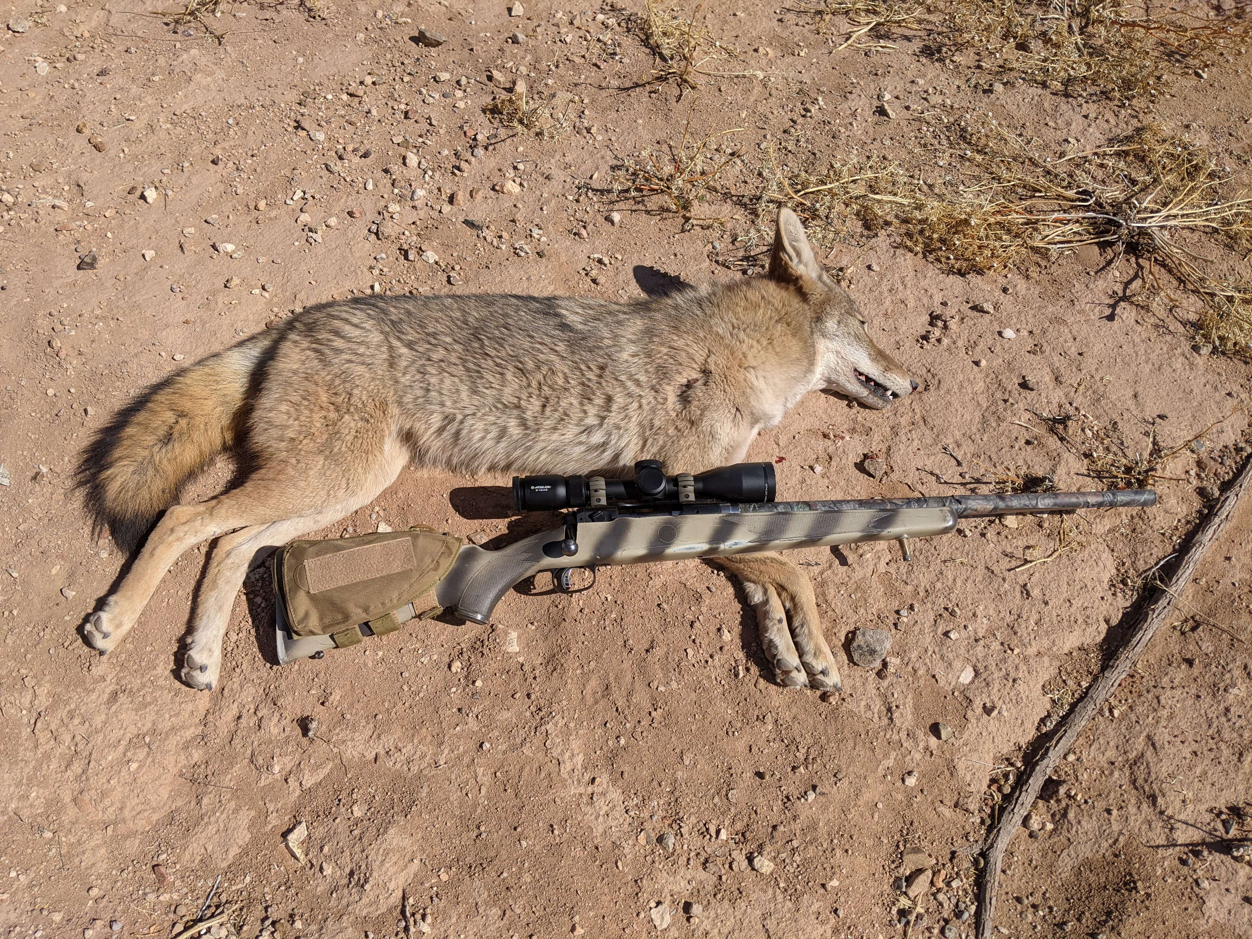

I'm mainly a coyote hunter and even the terrain I hunt and weapon I choose will mean different scopes. My coyote scopes run from 1-4x20mm in the thick stuff to 2-12x42mm in more open country. My coyote scopes will work just fine for deer also within the same terrains. My elk rifle wears a 1.5-4.5x20m, I prefer to stalk closer than shoot across the canyon. PD's, GS and targets have 4-16, 6.5-20's and 8-32 on them.
Bold reticles on the low powered scopes and fine ones on the high powered stuff.
A lower priced low powered variable for most hunting situations and then a better higher powered scope for long range and targets might be a better option than one high priced scope and try and make do with it.
6.5-20 for targets and small stuff.
2-12 w/BDC for out to 500 yards on coyotes
1.5-6 plenty good for coyotes out to 300 yards one of my favorite power ranges
1-4x20 on my combo guns(5.6x50R Mag/12ga) for close in work and still 300 yard capable on ones that hang up.
