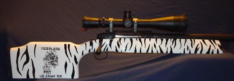

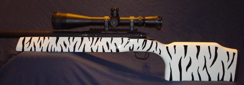

Gun configuration is a Savage 110 with a wood stock that has been heavily modified to act as a benchrest stock. It has been bedded, floated, you name it...
